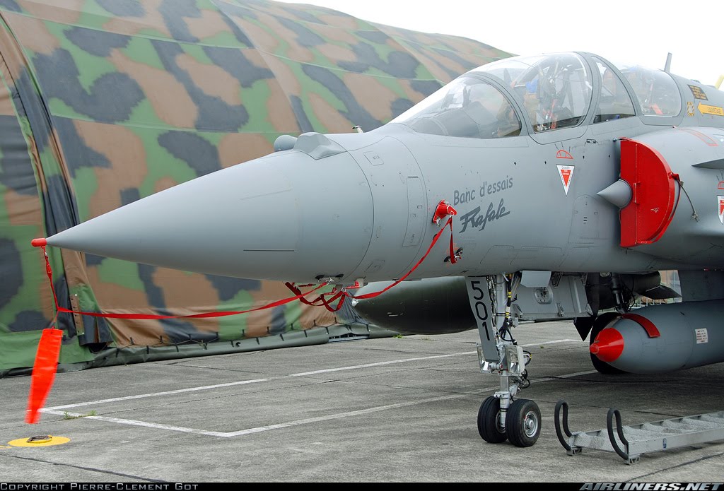

tiens voilà un exemple de modification
Well, not exactly a rafale picture, but The Mirage 2000 B501, which is used by the CEV (French flight test center) as a test bench for the rafale optronic systems... It has been nicknamed BOB (Banc d'essai Optronic Biplace / Optronic test bench Two seater).
It is also used to test the RBE-2 radar and the Link 16
http://rafalenews.blogspot.com/search?updated-max=2010-10-01T21%3A36%3A00%2B02%3A00&max-results=7
