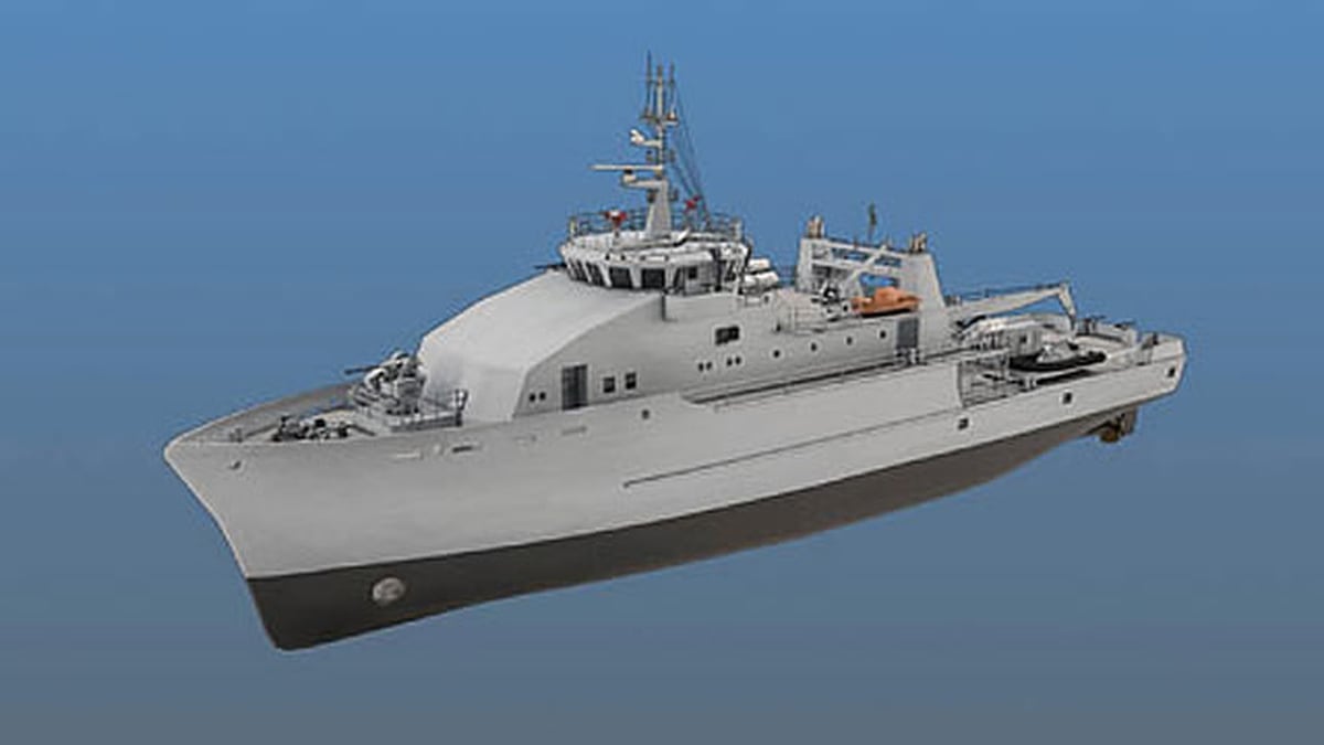

Le design du grand drone de surface de l'USN réutiliserait celui d'un supply fourni à la marine irakienne :
https://www.defensenews.com/naval/2019/12/21/the-us-navy-gets-its-large-unmanned-surface-vessels-in-2020-with-strings-attached/
"Senior Navy officials have talked about the LUSV as a kind of external missile magazine that can autonomously navigate to and integrate with the force, then shoot its missiles and return for reload, keeping the big manned surface combatants in the fight and fielded longer."
c'est un navire quasi de la taille d'un PAG, avec un Bau juste un peu plus large à 11,20m
300px-Iraqi_OSV_Al_Basra_(401).jpghttps://en.m.wikipedia.org/wiki/Al_Basra-class_offshore_support_vessel
