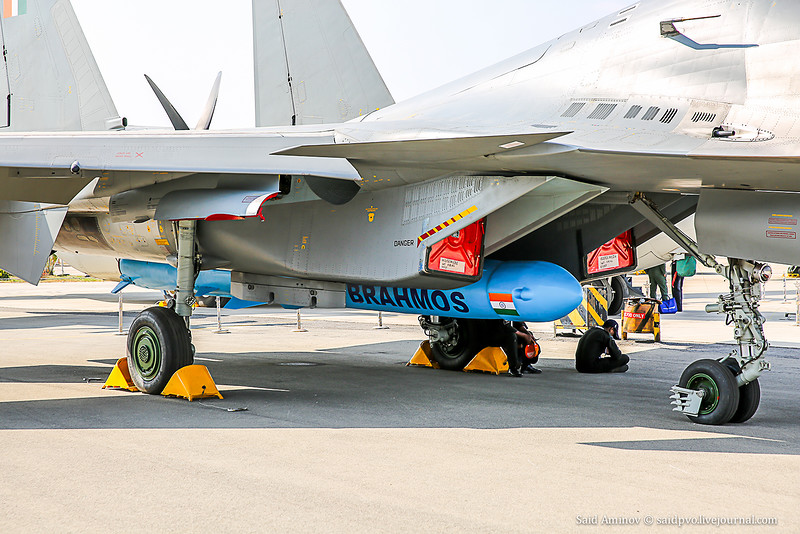

Le Brahmos pour ne pas le citer, les premiers essais de tir à partir de Su-30MKI vont bientôt débuter d'ailleurs.

Ils prévoient une version aéroportée moins lourde et moins longue parce que bénéficiant de la vitesse acquise par le porteur.
Oui le Brahmos NG. Cependant ce dernier n'existe pas encore et les tests actuels concernent le Brahmos A qui ne peut-être emporté que par le Su-30MKI.
Mais c'est vrai qu'au rythme auquel les indiens se décident: le Brahmos NG sera prêt pour l'arrivée des premiers Rafales en 2045... :biggrin:
On est quand meme a 2.6T et 8m ...
=> Oui mais çà ce sont bien les spécification du "A" : 2,55T et 8,40m exactement semble t-il.
"Sources inside from Brahmos said that, they will carry out first maiden test launch of Brahmos A missile by November, and with the induction date of next April, after completing three dummy Brahmos missiles and one actual missile, all four will be fired from the Su 30 MKI aircraft, first three would be evaluate the launching altitude, speed, fraction and aircraft stability, the final launch would be Brahmos in actual combat mode with warheads and on board seekers, once all tests are successfully completed, HAL will starts works on the first phase of modifying Su 30 MKI fleet from IAF inventory."
"Mainly the HAL is responsible for structural modification in the Su 30 MKI fighter jet, and Brahmos corp is responsible for Missile modification, the actual Brahmos missile size is 8.4 meter, and the Su 30 MKI some 22 meters from tail to nose cone, so they need to Shorten the missile at first, which results reduced weight too, normal variant of Brahmos weights some three tons, while the Air launched version slightly lower that is 2.5 tons."
"Brahmos CEO also mentioned about the ongoing project of Brahmos NG with the weight of just 1.5 tons able to be carried in medium fighter jets like Mirage 2000 and MiG 29, also a good chance of increased number of Missiles in front line warships and  adding the missile in smaller Ships like Missile corvette's and EEZ patrol vessels, the project expected to be completed before 2019."
http://images.google.fr/url?sa=t&rct=j&q=&source=imgres&cd=125&cad=rja&uact=8&ved=0ahUKEwi7n-zO2vnLAhVISRoKHZvgB3o4fBDlEwgEMAA&url=http%3A%2F%2Fsajeevpearlj.blogspot.com%2F2015%2F09%2Fbrahmos-missile-ready-by-april-2016.html&usg=AFQjCNF9vAob56nStXpqWe6OT3Oq-D8wYQ
Intégration du Brahmos "A" (pour donner une idée des dimensions gargantuesques) :
=> Pour les spécifications du "NG", ce serait donc environ 1,5T (1T de moins tout de même ! :mellow:) pour une longueur de 5m (3,40m de moins !!) et 50cm de diamètre ... Sacré boulot de miniaturisation si avéré (?), même en tenant compte du gain de la vitesse relative du vecteur aérien lanceur ... Je pense qu'on y est pas encore ...
Du reste comme cité au dessus et ci-dessous, il semble bien considéré "possible" l'intégration du "NG" sous "médium fighter" Mig29 & M2000, et donc pour le Rafale ...
