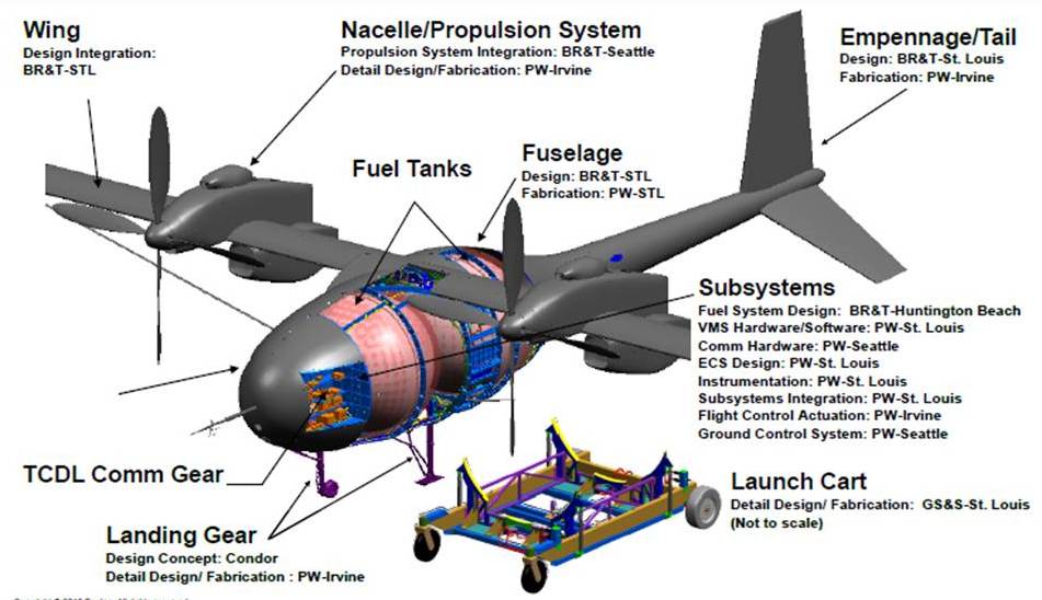

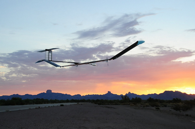

The radio horizon against flying targets is even further away, at 810km for targets flying at 3000m, which gives coverage all over Syria and part of Irak. For target flying at 10 000m, like most jets in transit, the horizon is at 1000 km.
UAV-Zephyr.jpg?wid=661&fit=fit,1&qlt=85,
https://therestlesstechnophile.com/2019/05/28/high-altitude-pseudosatellites-the-future-of-earth-observation/
https://theadvancingblade.wordpress.com/2019/05/12/high-ambitions-the-boeing-condor-uav/
https://www.airforce-technology.com/projects/phantomeyeunmannedae/
