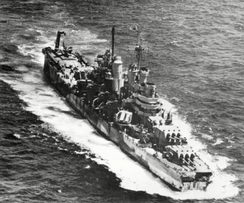

Il y a 10 heures, DrWho a dit :
e Pittsburgh mais après la "groooosse" tempête
:ohmy:
Sollicitations hors norme  sur toute cette finesse  caractérisées par des pressions de tossage  combinées considérables  au niveau du dévers ( flare slamming  ) , de l’étrave ( bow slamming) et du fond ( bottom slamming ) + techno soudure à ses débuts …..
“The loss of Pittsburgh's bow, as well as less severe structural damage suffered by the heavy cruiser Baltimore and the light cruiser Duluth, dramatically demonstrated both the power of nature and the sometimes unreliable strength of contemporary welding. The latter problem, which resulted from both a not-completely-mature technology and the pressures of wartime production, was one that reared its ugly head from time to time on other war-built ships, both during and after the conflict.
https://www.ibiblio.org/hyperwar/OnlineLibrary/photos/sh-usn/usnsh-p/ca72-l.htm
Fiches navire source ancien flotte combat USN page 82
http://www.marinehist.dk/orlogsbib/Blackmann.pdf
lisses secondaires cisaillées ,
Chez nous sommes passés à la soudure sur les croiseurs d’avant ww2 , Suffren/ Algérie , gain de poids et aussi qqs soucis de déverninage techno .
