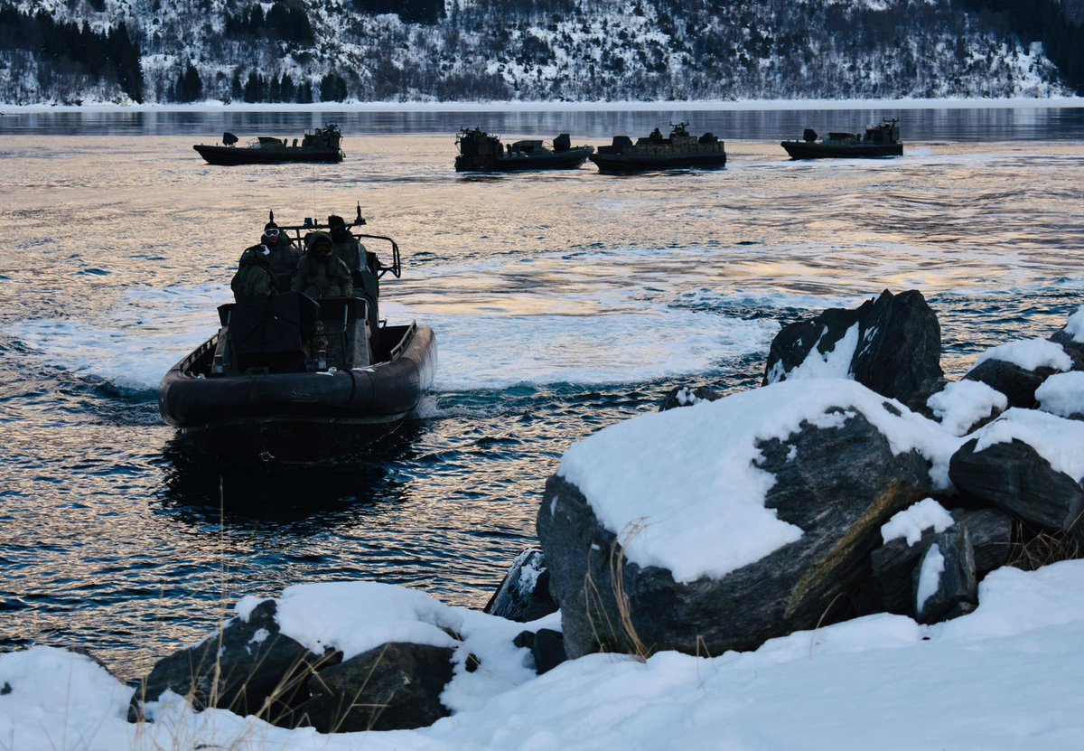

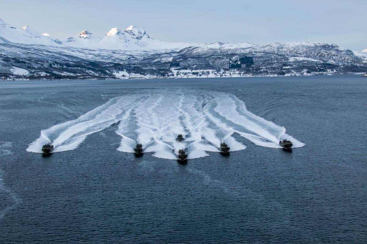

Les engins sont des "Offshore Raiding Craft (ORC)"
Ce sont des engins coques Alu, moteurs inboard et waterjets :
http://pdf.nauticexpo.com/pdf/holyhead-marine-services/11m-orc-mcv/32852-107319.html
On distingue assez bien les 2 configurations sur les photos. Je vous ai trouvé un article ou l'on voit bien la différence :
Photo showing the Offshore Raiding Craft in 2 configurations: the MCV fire support platform (bottom), with the armour-plating fitted and multiple GPMG and HMG stations, and the ACV troop carrying version (top)
The Aft Console Variant (ACV) is the troop carrying version. With the crew console situated at the aft, the ACV can carry up to 8 troops on saddle seats. The boat is armed with a forward-mounted HMG or single/twin GPMG. Optional amour-panels can be fitted to provide ballistic protection for the 2 crew and passengers.
The Mid Console Variant (MCV) is a dedicated fire support version. The MCV is fitted with Dynema armour-plating which protects against small arms fire up to 7.62mm ball. The steering console is situated near the middle of its length to create room for port and starboard aft gun stations. Weapon mounts are: (1x HMG / GPMG fwd, 2 x GPMG/HMG/GMG/Minigun aft). Up to 4 troops can also be carried on seating ahead of the console.
Source : http://www.eliteukforces.info/uksf-gear/offshore-raiding-craft/
